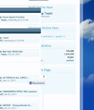

Douglas Taylor Active member Nov 21, 2011 #1 Is there a method of setting the minimum page width in order to avoid content overlap as in the following photo? Thanks in advance
P Paul B XenForo moderator Staff member Nov 21, 2011 #2 Style Properties -> General -> Page Width Controller Change the value in the Miscellaneous field. Upvote 0 Downvote
