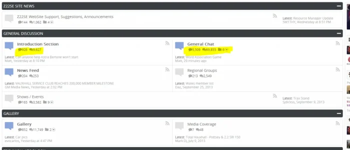

You can't strip whitespace around non-block level elements without causing visual glitches (iirc things like thread counts lose spacing on forum home)

I hadn't thought about the issue with non-block level elements. I'll have to think of a way to expand the code to work in those instances.

Just noticed that while running it on my site.
