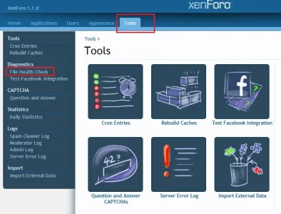

i said to upgrade and it came back with this
There are at least 6 file(s) that do not appear to have the expected contents. Reupload the XenForo files and refresh this page. Only continue if you are sure all files have been uploaded properly.
Is that because I jsut uploaded the library folder and nothing else?
