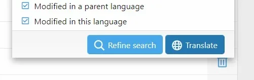

When doing a search for phrases with "resource" you only get the first 300, so there is not an easy way to even locate them all.

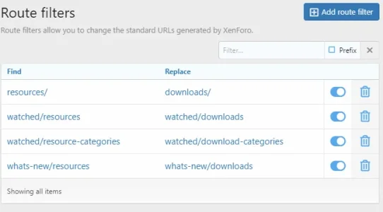

Here were the route filters I needed:
@Brogan I was able to get almost all routes changed over easily except for a search query reference - "search/?type=resource"
Is there anyway to mask the query reference?
