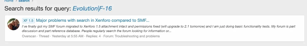

If I repeat the exact same search in Xenforo I get:
Search Results for Query: evolution f-16
  1. The following words were not included in your search because they are too short, too long, or too common: f, 16
And basically it just searches for 'evolution' and my topic is buried deep in the results.
If by some miracle I remember the full and complete name of the topic and search for that:
Search Results for Query: ADF to LWF: Evolution of the General Dynamics F-16
  1. The following words were not included in your search because they are too short, too long, or too common: ADF, to, LWF, of, the, F, 16
It gives me the actual topic I'm after in 8th position, due to throwing away most of the relevant keywords for being too short.
So I figure out two problems. First, I need to alter MySQL to allow 3 character searches, then update Xenforo to match. I can search for ADF or LWF now, though F-16 is still impossible as it searches for F and 16 separately.
Second, I need to put the search query in quotes. This now works a little better, but it still puts my desired topic notably lower down than SMF.
