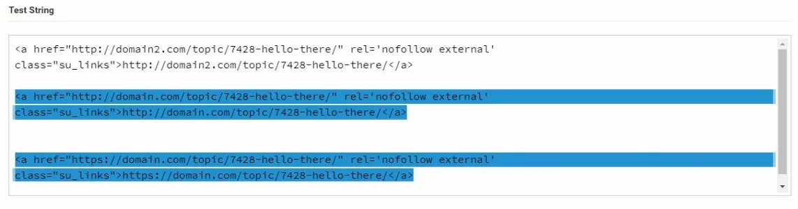

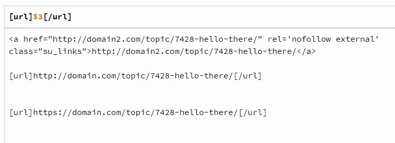

Should work, please... make a backup, make test runs bevore you save anything to your database!
If I understand you right, try this:
Fast search:
:\\domain.com/topic/
Important: You have to replace "domain" with your real domain!!!
Regex:
#(\<a\shref=\"https?:\/\/domain\.com\/topic\/[0-9a-zA-Z-]+\/?\")([ a-z=\'\"_]+\>)(https?:\/\/domain\.com\/topic\/[0-9a-zA-Z-]+\/?)(\<\/a\>)#siU
Match:
Replace:
[url]$3[/url]

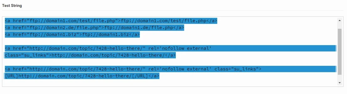

No not in profile posts, only in postings without any code change.
For postings and such links as you post above:
fast search: "http" (or a second run with "ftp")
Regex:
#(\<a\shref=\")((ftp|https?)(:\/\/[0-9a-z_-]+.[0-9a-z]+\/?[0-9a-zA-Z_\-.\/\)]+)+)([0-9a-zA-Z:.\[\]\/\" \=\'_\-\>]+)(\<\/a\>)#siU
That looks for http, https, and ftp links
match test:
Matches all such types of links you see above and we use only one regex match group in next step....

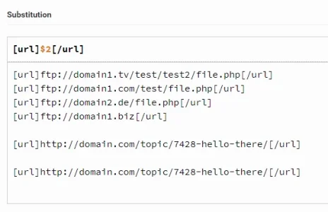

replace:
So we put the one matching group inner a url bbcode a voila, we have working simple links
But... when you need it for profile posts - its not so helpfull for you. As long as the search and replace tool its only working for postings. Sorry.
