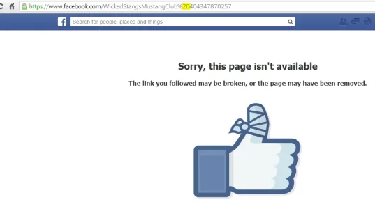

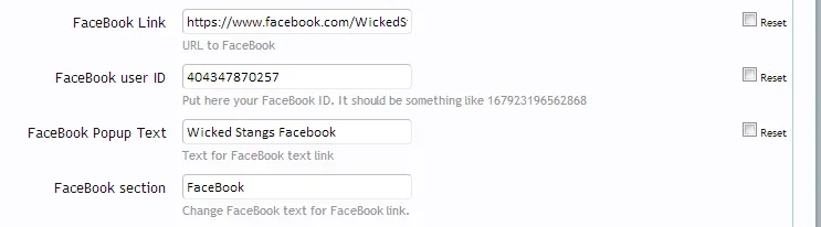

@lms everytime I put, my Facebook ID it takes me to the wrong page?
Also how do I get the Facebook image to the right?
When I click on the above Facebook Link it takes me to this page.. For some reason it adds the %20
To make the actual page work I found that it should be like below.. /facebook ID ..

@wickedstangs
In the template lms_FooterPie search by:
<a href="{xen:property lms_FooterPie_FacebookLink} {xen:property lms_FooterPie_FaceBookID}" target="_blank"
delete the space between {xen:property lms_FooterPie_FacebookLink} and {xen:property lms_FooterPie_FaceBookID}
would be something like this:
<a href="{xen:property lms_FooterPie_FacebookLink}{xen:property lms_FooterPie_FaceBookID}" target="_blank"
In the facebook link put
https://www.facebook.com/
In the facebook user id put
WickedStangsMustangClub
To display social icons
AdminCP --> Home --> Options --> XenFácil Footer-Pie --> Select the icons for Facebook and Twitter.
