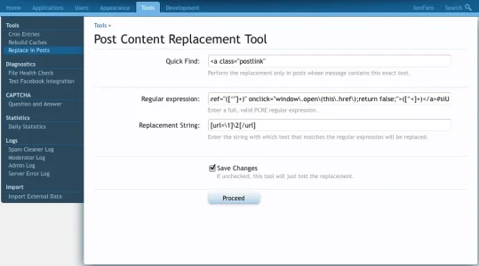

Hi,
After upgrading from phpBB3.0.10, the links in post are showing as plain html as per the below:
<a class="postlink" href="http://issues.pageturninteractive.com/CoverStory/four/?ptie=forums@chrisknott.co.uk" onclick="window.open(this.href);return false;">http://issues.pageturninteractive.com/C ... nott.co.uk</a>
Is there an automated way to resolve this post upgrade?
Thanks,
Matt

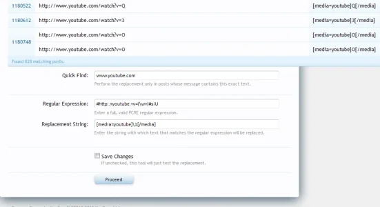

I'm also having issues with youtube links.
The link are all now the full URL, and not embedded
http://www.youtube.com/watch?v=j4VAF9QHxR
I've tried the below:
quick find
www.youtube.com
regex
#http:.+youtube.+v=(\w+)#siU
replace string
[media=youtube]\1[/media]
It's matching the string, but only the first letter/number of the video ID.
Thanks,
Matt
You will need to better define the ID by specifying what comes after it. Is there a common delimiter after the URL? Such as a space character or bracket?
A space:
#http:.+youtube.+v=(\w+) #siU
A bracket:
#http:.+youtube.+v=(\w+)\[#siU
Or try this regex:
#http:.+youtube.+v=(\w+?)#siU
That almost works, unless there is a - in the video ID.
A space:
A bracket:
Most of the posts are single posts with just the video URL in them, and nothing else after the URL.
