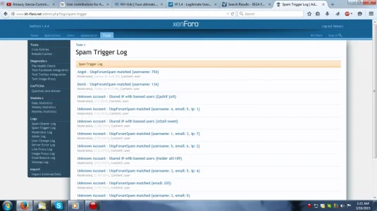

Ah, here we go. Forgot there was a spam trigger log. It was the usernames, @Martok:

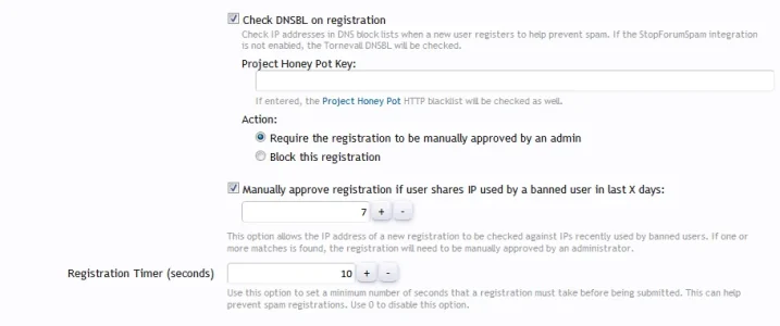

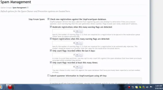

I know you didn't directly ask, but here are our spam settings (I think they're just the default):
View attachment 100770 View attachment 100771
Yup. The built in SFS settings kind of lack the ability to be very specific. If you could not flag on name only then it would save you the hassle of those but would end up letting through unique named spammers through in trade. To tune more specifically requires an addon. One of the things is the majority of the spam is coming from very identifiable sources, matching against a database is great but there are easier ways to stop them at the moment.
Basically the system is functioning perfectly. There is nothing to troubleshoot, nothing wrong. Just a limitation. Spam bots use common names occasionally. More often it's legit users.
