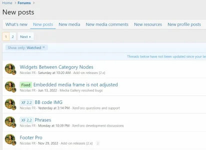

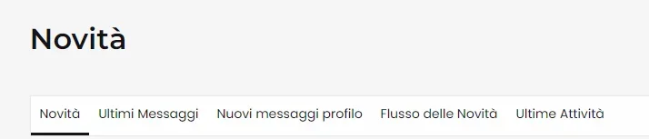

From here, is missing a tab for calling ONLY the latest messages NOT READ. How can i set this tab?
Now, users read all the latest messages, including messages already read.
they need a list of NON READ LATEST messages. sems to be a basic calling, isn't it?
i try to search for hours in admin control panel without success... is there a way to show this kind of list?
thanks.
Should to be Ultimi Messaggi, the second tab

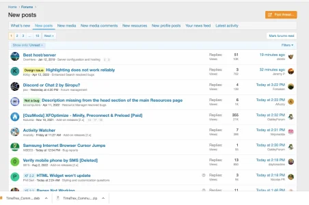

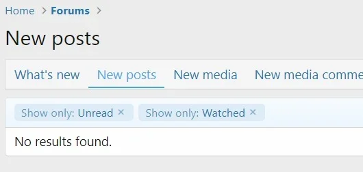

Unread posts on the site... even in areas I really don't care about.

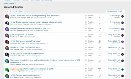

And now my watched/followed content - again, topics that I have already read, but are still followed by me.
Unless I'm missing my point... it appears what YOU want is only unread followed topics... and that isn't a "default" ability... as I said, AFAIK it will require an add-on.

When i enable those 2 filter together i only see my UNREAD WATCHED CONTENT. 🤷‍♂️

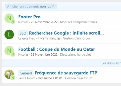

UNREAD
WATCHED
Note that the WATCHED filter already separates read and unread content.

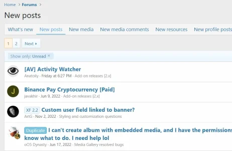

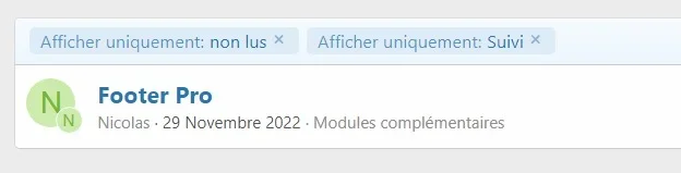

UNREAD & WATCHED

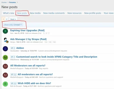

if you read Footer Pro, then turn to the search with 2 filters, do you see again Footer Pro?
We all yes. Even if it is already read it showing with filter Unread set to on.
No, it doesn't appear anymore, but maybe you used the backspace in your browser and at that moment it even appears read because you are on the same filter/search request if you make a new one on it read content disappears. I suggest that you select the 2 filters UNREAD and WATCHED then save them by default so that each time you go to NEW POSTS you will have a "new" UNREAD and WATCHED request with the correct results.
If you use backspace it still appears but unbold.
