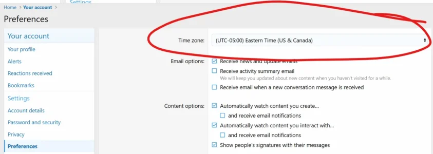

My personal settings: UTC-6:00 Central US
What, exactly, do you mean by "personal settings."
I discovered that when I'm on my own forum, viewing it as a member, that the time zone in my preferences was set at UTC instead of my own time zone. Shown here corrected.
Is that what you meant?

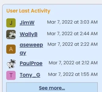

This is a screen clip I just took, the current time is 10:20 Central Standard Time. You can see the times the users were on earlier this evening and how they are being reported
JimW was at 9:03PM our time, WallyB at 8:44PM, etc

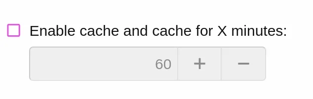

Oh, I see now. This issue only affects the last activity listing on the member list, not on the profile or user card. This is a bit of a design issue where the results are being cached by a visitor (or user in the UTC timezone).
We'll take a look at it, but in the meantime you can disable caching for the member stat to work around this:
@Jeremy P , your work-around did just that. Disable the cache and it reports properly. Makes no sense but it works.

Can you explain how the cache would be useful for this type thing and why it would be enabled/disabled
It caches the results for the given period of time so that they don't have to be computed every time the page is viewed. It's useful when it is computationally expensive to fetch the results. In this case, it's probably not especially useful.
Because of a design flaw, the cache currently writes the results in the time zone of the user who triggered the computation. So if the cache is stale, a visitor from the UTC timezone will cause the results to be cached in UTC time.
