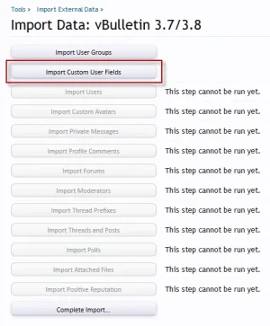

One question mark for me is moving all of the custom user fields from vB 3.7 over to XF. The big board I may move makes heavy use of the custom user fields; having everyone redo them will only upset the natives. ;)

Custom user field imports are handled in XF:
As for the server, moving to XF will probably ease the load, even when moving from vB3.8. Like you said, in time it might still be neccessary, but at least you would buy time to properly investigate :)

That's a relief with the custom fields!
