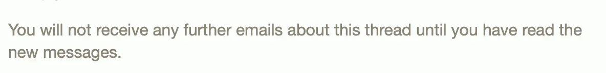

I’m not sure I’ve ever seen one of those, where would that show?
In the email. Sorry I did not make it clear I was referring to email notifications.
