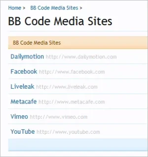

That's great, thanks @Brogan I will give the YouTube method a try (after backing up obviously).
I also now noticed SoundCloud. Is there a list anywhere of what media types xF supports and what their corresponding shortcodes are meant to be now?
