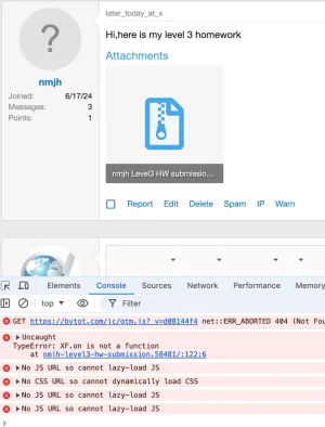

Created a testing site at bvtot.com and use a backup database of my production site (2.2.16)
Updated to 2.3 RC fine but a lot of items are not working. I believe it's mainly javascript related.

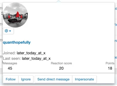

1) All the timestamp are shown as later_today_at_x but when hover on it, it shows the correct time.
2) All the usercards are messed up. Again, maybe JS related.
3) Editor are missing icons, etc.
Below are a few console errors from the browser.
Uncaught TypeError: XF.on is not a function
at masters-degree-vs-work-experience.58345/:199:6
Uncaught ReferenceError: jQuery is not defined
at editor-dialog-code.min.js?_v=2b545e65:4:419
Uncaught ReferenceError: $ is not defined
at core.min.js?_v=2b545e65:1:2852
at NodeList.forEach (<anonymous>)
at makeUnitsResponsive (core.min.js?_v=2b545e65:1:2746)
at core.min.js?_v=2b545e65:1:3602
Where do I start?
