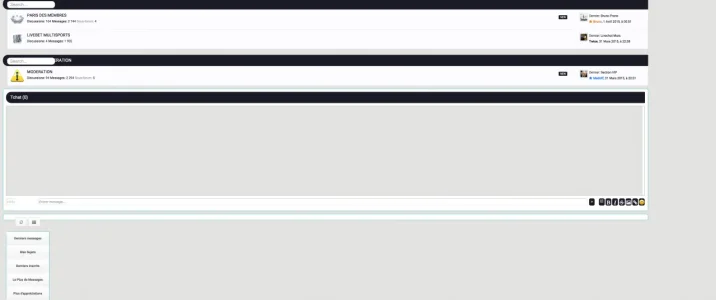

Hello all,
I made a subdomain and put this there => $config['javaScriptUrl'] = 'mysubdomain/js'; and add this one to the config.php file.
However, when I add this one, I have a big bug on the forum and JS doesn't load...
I have transferred JS to the root of the subdomain and tried under public_html too.
Under the CP and performances, I have checked local hosting cause the box "google API Ajax" was checked but no change...
What's wrong in this case?
Thanks for your help.
PS: I will add the data line after the JS line but the data folder is really big and I want to test first with the JS folder...

What happens when you go to the subdomain directly at put in the full URL of the java script? Does it actually load anything?
Nothing but the folder is empty a part the JS one.
Shall I transfer anything in addition of the JS folder?
I know, I can transfer the data folder but before transferring this one, I want to make a test with the JS one cause this one is not too heavy...
