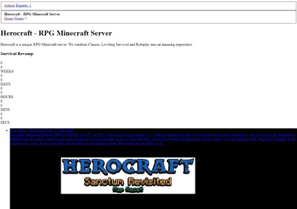

Installed latest Ngnix and now XF isnt loading properly?
Kainzo
Installed latest Ngix and now this..
herocraftonline.com
Unsure what could have caused this.
Note: I am self hosting. Have been using XF since 2011 and have never encountered this issue before.

Probably going to relate to this
(index):21 Mixed Content: The page at 'https://herocraftonline.com/main/' was loaded over HTTPS, but requested an insecure stylesheet 'http://herocraftonline.com/main/css.php?css=EWRporta2,EWRporta2_ArticleList…ices,panel_scroller,profile_post_list_simple&style=31&dir=LTR&d=1518540542'. This request has been blocked; the content must be served over HTTPS.
(index):41 Mixed Content: The page at 'https://herocraftonline.com/main/' was loaded over HTTPS, but requested an insecure stylesheet 'http://maxcdn.bootstrapcdn.com/font-awesome/4.3.0/css/font-awesome.min.css'. This request has been blocked; the content must be served over HTTPS.
(index):1 Mixed Content: The page at 'https://herocraftonline.com/main/' was loaded over HTTPS, but requested an insecure stylesheet 'http://herocraftonline.com/main/css.php?css=xenforo,form,public&style=31&dir=LTR&d=1518540542'. This request has been blocked; the content must be served over HTTPS.
(index):1 Mixed Content: The page at 'https://herocraftonline.com/main/' was loaded over HTTPS, but requested an insecure stylesheet 'http://herocraftonline.com/main/css.php?css=EWRporta2,EWRporta2_ArticleList…ices,panel_scroller,profile_post_list_simple&style=31&dir=LTR&d=1518540542'. This request has been blocked; the content must be served over HTTPS.
(index):1 Mixed Content: The page at 'https://herocraftonline.com/main/' was loaded over HTTPS, but requested an insecure stylesheet 'http://maxcdn.bootstrapcdn.com/font-awesome/4.3.0/css/font-awesome.min.css'. This request has been blocked; the content must be served over HTTPS.
Looks like you have a LOT of calls to an HTTP resource and it should be HTTPS.

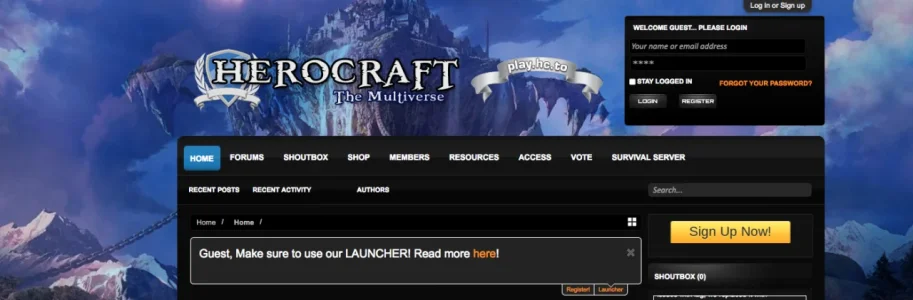

Answer... yep, looks like it
You need to disable that crappy RocketLoader.... and there may be another setting for compression that you need to disable.
Are you using Full SSL, Flexible SSL?
Is this something you just did?

Actually, if I recall the sequence of events.. It may not have been updating to Nginx latest...
1. Saw that I had a handshaking error in cloudflare so I went from "full" to "flexible" SSL.
2. Looked into DigitalOcean and saw that my machine power cycled
3. Updated 70 packages in Webmin (including Nginx)
4. Saw the default apache message (Weird?) on the websites so checked Nginx status
5. Something else was binding to the ip so had to clear it and restart Ngix
6. Herocraftonline.com reacted as such.
Maybe my SSL cert went bad? I really dont know much about it and I am at a loss why it just randomly died or expired...

I added Flexible because it wouldnt even let me into the domain otherwise. I think my SSL cert expired or became invalid? im unsure of that.
Uncheck the 'Minify CSS' option under the 'Speed' tab in CF.
Unchecked Minify all the things and purged cache to see if it works.
Retested and it still is mishapen and things... does anyone know how I can resolve the SSL issue?
