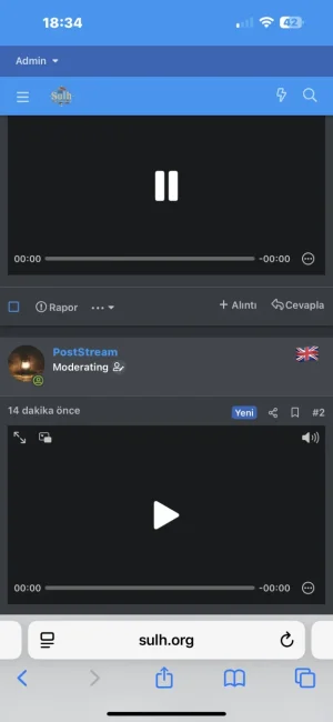

The videos I uploaded directly to messages are not working. I just noticed this. Videos from YouTube and similar platforms work, but the ones I uploaded directly do not.
