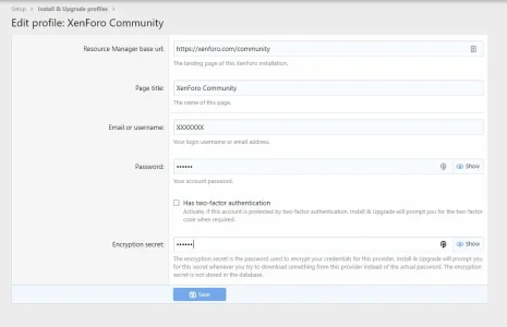

Daron,
Please have your developer set up a Xenforo to repeat these steps. Add an Install & Upgrade profile and add the Xenforo Resource Manager. See below and continue steps.
Username and password are your Xenforo Forum username and password and the secret is whatever I choos.
You then need to try to Install an Addon by using the Install/Upgrade from URL as below:
It will fail every time from Xenforo Resource Manager links. Full stop.
My point about API keys is that the only websites where Install/Upgrade by URL work use API keys to authenticate. If your developer can get the Addon to work by usernam/password then that's great but it currently does not work when you try to install/upgrade by URL.
