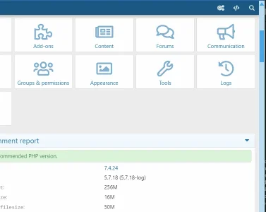

I did a scrollbar restyling for my public side that ended up also styling the admin scrollbars. But, I did this through the template modification system as an add-on, which adds the modification to the bottom of the extra.less template. (I would actually call it "unexpected behavior," to be honest.) Here's the result:
@Brogan you said adding content to the public styles extra.less template won't affect the admin templates but it can actually do it?
I am a bit confused.
But overall, I think the answer is that there isn't any official way to change the font size of the admin panel.
