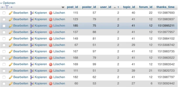

Ok table name ist 'phpbb_thanks' , these are the columns title.
post_id
poster_id
forum_id
topic_id
user_id
thanks_time
192575
Can someone help me to import/parse them in to XenForo?

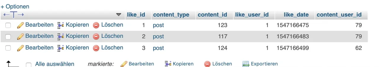

Ok and the table for XenForo is "xf_liked_content" , and these are the columns.
like_id
content_type
content_id
like_user_id
like_date
content_user_id
192675
I am not sure but i guess those columns just need to be copied in to the equivalent column.
like_id = randomcounter
content_type = everytime 'post"
content_id = post_id
like_user_id = user_id
like_date = thanks_time
content_user_id = poster_id
