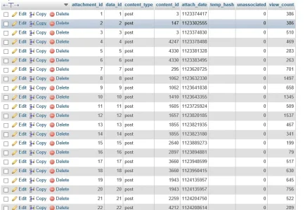

Here's my source database. You can easily tell there are 16 attachments to that post:

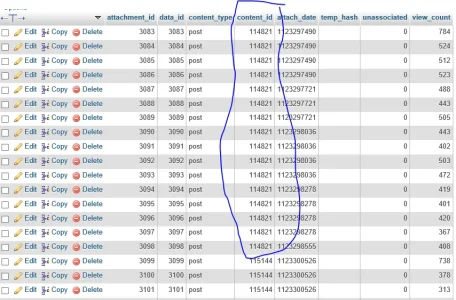

Here's my target imported db. You can see that at most a post has about 1-2 attachments:

The target is a fresh install of XF so there are no addons and existing posts\threads\forums etc. Completely empty. So essentially I'm simply mirroring the boards during the import. So therefore, i should see a 10+ rows with the same content_id back to back. You can see that in the target db there are indeed back to back rows with the same content_id, but that is at most 2.
