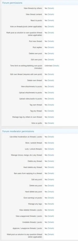

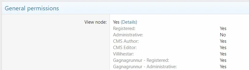

Does it mater if a User's Primary user group is Registered and Secondary Administrative..
Does Xenforo add administrator automatically to secondary?
That's correct.
All members have Registered as primary.
If the issue is with specific forums, you need to run the analyser on the node.
