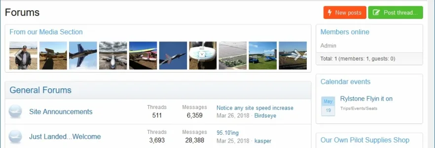

I have placed the Media Slider Widget across the top of the forums:

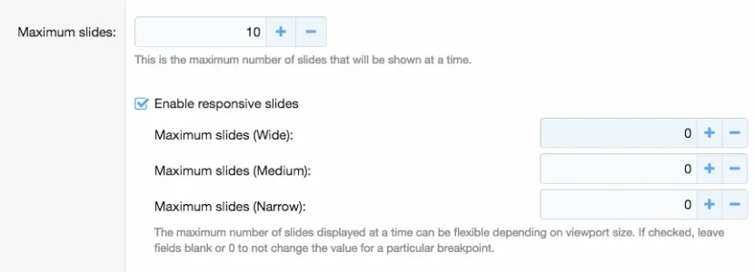

With these settings:
Now when you bring the view down from full screen to a window you get:
Now an even bigger problem is when you then maximise the window the slider and images start flashing on and off
This is in Firefox and Chrome...In Edge it is the same but without the flashing. This is a bug and makes the XFMG widget unusable across the top of the forums

At the same time, we've improved the slider so it now has some flexible responsive settings that can be configured for each widget. These optionally control the number of slides that appear at a time at different viewport sizes.

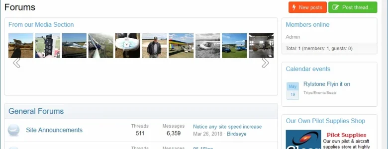

For example, as it stands right now, your 10 slides per page will always be 10 slides per page, even on a much narrower display, sort of like this:
Which isn't too bad, you might prefer it like that. Alternatively, you could specify that when the viewport is narrow, you instead display 4 images at a time:
