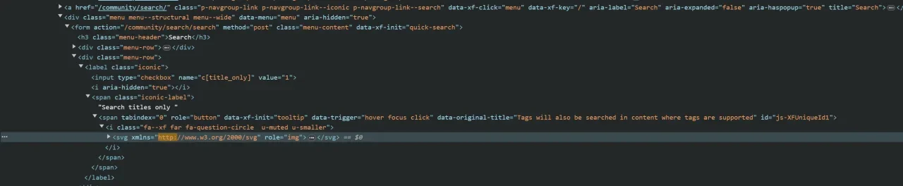

Ivancas Well-known member Feb 28, 2024 #1 Affected version 2.2.15 Not a big deal but the svg xmlns should be updated to HTTPS
Jeremy P XenForo developer Staff member Feb 28, 2024 #2 The XML namespace is an opaque identifier and http:// is correct: Why does xmlns use http not https? · Issue #738 · w3c/svgwg This is not really an issue per sé, more like a request for information. I noticed that it is normal to see http:// used as a protocol reference to xmlns links and even doctypes. The following is m... github.com
