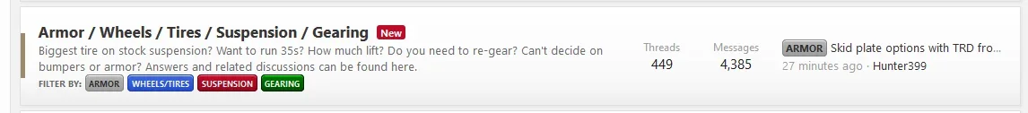

I have it running and it looks nice. This is the forum description:
HTML:
Biggest tire on stock suspension? Want to run 35s? How much lift? Do you need to re-gear? Can't decide on bumpers or armor? Answers and related discussions can be found here.<br />
<small><b>FILTER BY:</b></small>
<a class="labelLink" href="/forums/armor-wheels-tires-suspension-gearing.8/?prefix_id[0]=3">
<span class="label label--silver"><small>ARMOR</small></span></a>
<a class="labelLink" href="/forums/armor-wheels-tires-suspension-gearing.8/?prefix_id[0]=1">
<span class="label label--royalBlue"><small>WHEELS/TIRES</small></span></a>
<a class="labelLink" href="/forums/armor-wheels-tires-suspension-gearing.8/?prefix_id[0]=2">
<span class="label label--red"><small>SUSPENSION</small></span></a>
<a class="labelLink" href="/forums/armor-wheels-tires-suspension-gearing.8/?prefix_id[0]=31">
<span class="label label--green"><small>GEARING</small></span></a>

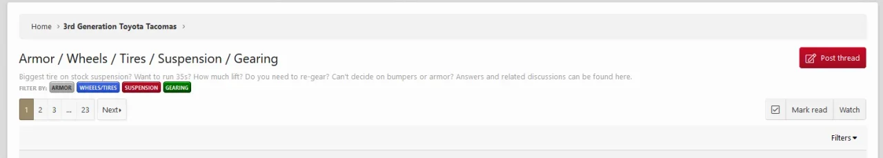

This is what it looks like:
The only issue I see with this is, if you ever change the color or wording of your prefix, you need to manually change it here as well.
