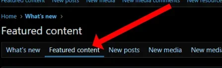

I'm not using any Featured Content widgets but I still have this in my menu with 0 results under it. How do I remove it?

Deactivating it in Navigation removes it from the tab, but not this menu bar. And I am not utilizing this function (widget or otherwise) so it should not be in the menu.
I had to do a template edit, it would be nice if it was removed from the moderator menu also. There are a few functions like this that I think should be easier to disable and get rid of any trace of them.

From this:
To this:
