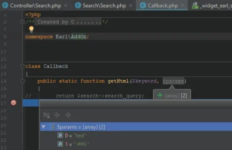

But this is not working, when I debug the code, This string value: "##0" coming as $param o_O:unsure:

yes simple strings works fine, but if I put a variable, it gives "##0" as a string, and If I put another variable, it gives "##1", and another, "##2,.. so on.
func_get_args() also returns same strange "##0" strings :rolleyes:

Yes,
HTML:
<xf:callback class="Earl\\AddOn\\Callback" method="getHtml" params="['test','{{ $context.search.search_type }}']">{$context.search.search_query}</xf:callback>
and
HTML:
<xf:callback class="Earl\\AddOn\\Callback" method="getHtml" params="['test','{$context.search.search_type}']">{$context.search.search_query}</xf:callback>
gives the same result as in screenshot
