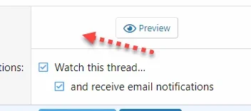

I modified helper_attach_upload and it becomes this:
The button is gone but the space is still clickable and will open the normal file selection window.
The second thing is where is macro upload_link? Thanks.

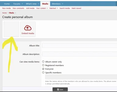

I realize this thread is older, but I need help making this solution work. My server host must have security settings that are preventing the "attach files" button from working correctly and now that we're using XF 2 our members keep trying to use the attach files button even though it never completes the process, and I'm tired of repeating myself to those who can't/won't read my announcements that it is not functioning.
I tried the suggested template modification but I'm not very experienced with code at all and probably did not do it right as nothing changed. I'd like to make the button disappear so they'll look at the toolbar above and use the "insert image" button that actually works. I just need someone to please break down the addition of the code mentioned in more detail so my old, uninformed brain can figure out how to implement it. Thanks in advance.

Thanks! It worked perfectly. I was trying the other method shown further above (why I quoted the post by Bespoke, which I could not get to work. These things are scary for me, the last thing I want to do is blow up my XF installation. Thanks again. (y)
Well, I just found out it works on replies to posts, but not on new posts in a new thread. The attach files button is still visible when starting a new thread. My concern about the other method shown further above (in the template with helper_attach_upload, macro upload_link) was that I was not sure where to paste it in. I tried the bottom as you suggested with your answer but it did nothing.
