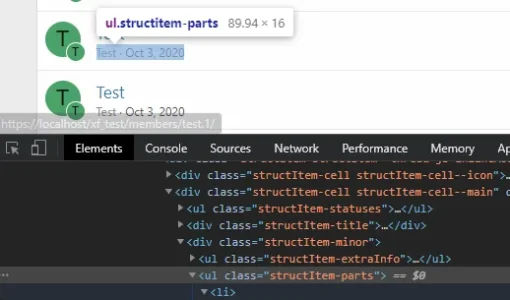

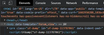

You can use the browser inspector (F12, then Console tab) to work out what to target.
Identify the template name - in this case forum_view.
Then identify the specific element - structItem-parts.
1602950433548.png.
Then create the code to remove it from the template.
Less:
[data-template="forum_view"]
    .structItem-parts
        display: none;
Further changes may be required to make things line up properly, etc.

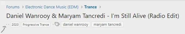

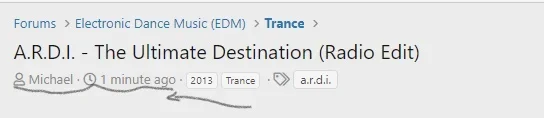

Well thank you for the explanation. This helps! I learned a bit more and i see now how i can do these things on my own. One last question regarding this then. I cant seem to find the correct class name to remove the dots that appear between username and creation date (on thread view template under the title). How do i remove those?

Thanks man, this works perfectly.
Didn't need to do any additional changes at all either.
