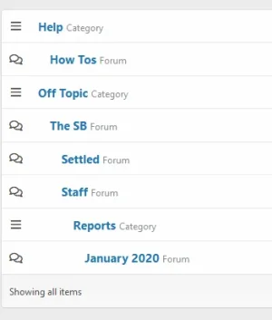

On an external PHP script, I'm using the following the code to fetch the nodes. My requirement is to display a tree-like structure of category-forum on a page so that a user can select a forum from the list. The code is as follows:
PHP:
$nodeRepo = \XF::app()->repository('XF:Node');
$nodeList = $nodeRepo->createNodeTree($nodeRepo->getNodeList());
foreach($nodeList as $obj)
    print_r($obj);

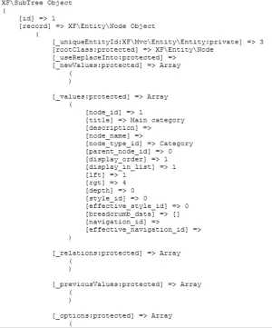

This prints out the following:
I'm able to access the node values with $obj['record']->title but how would I get the children of that node?
Have a look at the methods available on \XF\Tree (and \XF\SubTree). In particular, there is children() which takes an option node ID and returns a sub-tree of its children, if that's what you wanted.
Thanks for that. I went through the methods and tried to call them. The returned data is again in a complex form that I'm struggling to comprehend. But let me see if I can figure it out my more trials and errors.

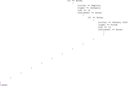

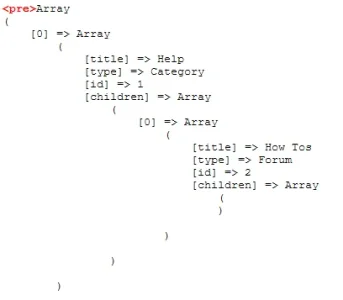

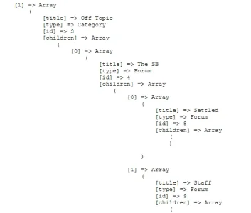

So the end result was that this:
was converted to:
I can now generate the appropriate HTML to form a tree structure from the above PHP array.[/ICODE]
