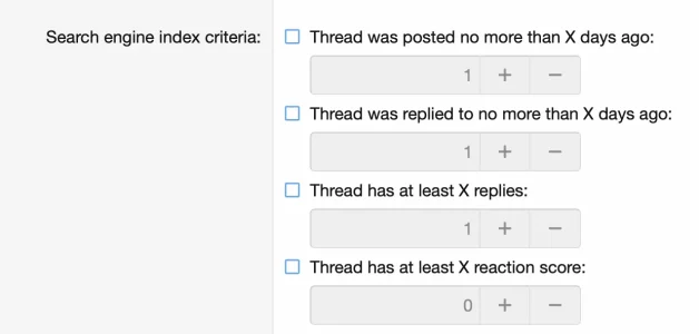

But 2.3 added thread level setting for search engine indexing and that does not seem to be excluded from sitemap from what I have seen.
Yes it added individual thread noindexing, but was there previously only under thread criteria and I'm fairly sure they were not included in sitemap so should be likewise for manually noidexed now with 2.3
