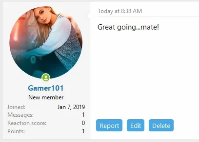

I'm simply trying to enlarge the avatars just a bit in message view, but when I go into setup.less and make the medium size a little bigger (as seen here: https://xenforo.com/community/threads/avatar-size.135801/ ), it does work, but every avatar gets just a little bit blurry. Looks like it's upscaling from the standard 96x96 avatar size when I do so instead of downscaling from the 192x192 size as it's supposed to be doing. Reuploading an avatar doesn't fix it either.

Try the template edit in message_macros, changing m to l as stated here? https://xenforo.com/community/threads/postbit-avatar-size.152096/#post-1273579
This worked perfectly! Thank you! I thought for a while that it couldn't be done.

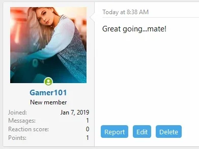

Jordyn's solution works like a charm. No blurring. Basically, for every "parent" style you have (style that doesn't have anything inherited from another style), go into message_macros (search for it on the top right corner of the admin CP) and change size="m" to size="l" and then just copypasta this into the style's extra.less:

Awesome guys. I "think" i found a much more simple code which only effects Conversations and Posts. This doesn't mess up anything else on mobile etc.
Give this a test please.

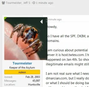

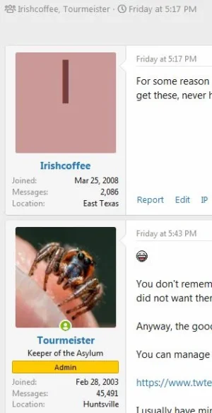

Okay, so one last issue I just noticed. When reading a thread or viewing a conversation, users that have not uploaded avatars but have the letters all look like this,
192481
The letters are all shifted.

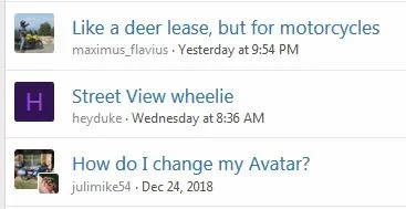

In a thread list in any forum, they look fine,
192482
Any idea what might be causing this?

Everything looks exactly the same and before...
Regular images are centered, but the letter based avatars are all shifted down so that the bottom of the letter is cut off.
I played around with Dynamic avatar base line height in the Avatar style properties and found that if I use a value of .75, the letters are centered top to bottom when viewing messages/conversations. However, when viewing a thread list where the avatars are smaller, they are now shifted up... 😕 I cannot find a value that gets both centered.

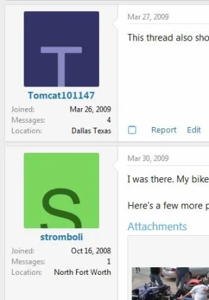

So I just updated to XF 2.10. The dynamic text avatars are now shifted UP toward the top of the avatar,
194788
instead of down like they were before in XF 2.012 as shown here,
It only happens when viewing messages in a thread or conversation. When viewing nodes and node lists, they are centered.
