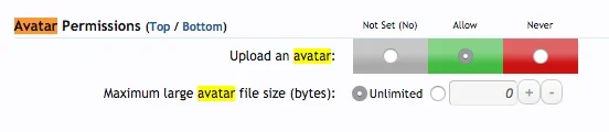

EDIT2: A little question, just before I'm done. For some reason avatars can't be greater than 50kb, and I've been looking for ages for that config to change it, where is it?
service php5-fpm restart will probably be needed.
Avatar file size is set in your User Group Permissions
