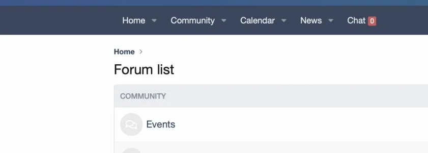

Greetings everyone. I am wondering why my nav bar isn't showing the current selection while under the selected tab.
I wanted to add a "Community" navigation link instead of the default "Forums" title. Doing this affected the current selection drop down arrow on nav bar.
How can I change this? See attached photos.
Also, How can I change the name from "Form List" to something else? Which template do I edit?

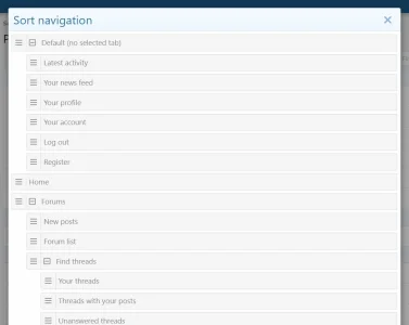

Edit the public navigation in ACP and add/sort sub-menus as you wish.
/admin.php?navigation/

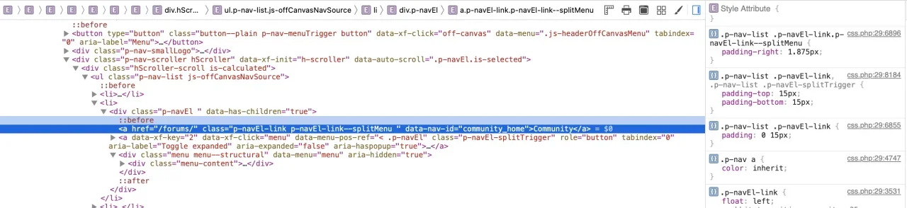

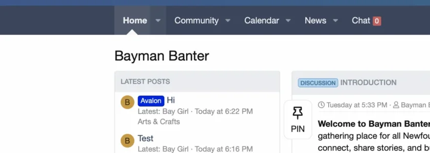

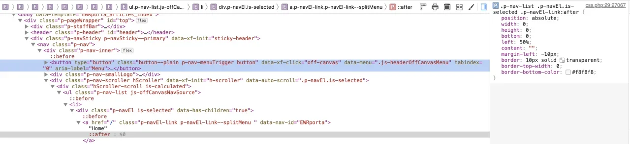

Sorry, maybe my post doesn't do a good job of explaining my goal I am trying to achieve. Basically every other tab has this css inside except for the community tab. I am wondering how to add it to that tab in particular. Also, I do not have that add-on you're using to sort. Here is the code:
.p-nav-list .p-navEl.is-selected .p-navEl-link:after {
    position: absolute;
    width: 0;
    height: 0;
    bottom: 0;
    left: 50%;
    content: "";
    margin-left: -10px;
    border: 10px solid transparent;
    border-top-width: 0;
    border-bottom-color: #f8f8f8;
This adds the little arrow showing the current selected tab.

Add this to the top of the forum_list template :
HTML:
<xf:page option="section">community_home</xf:page>
It's native, just click on the sort button on the top right of the page.

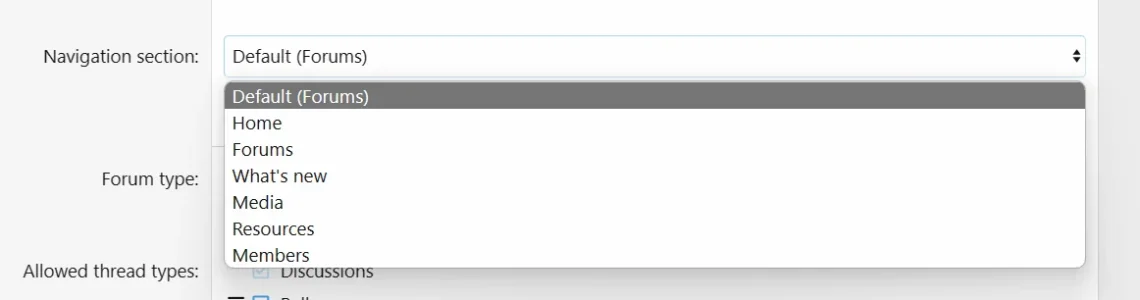

But for nodes and categories, if you ant to keep your custom tab, just edit them and select the right navigation section ;)
