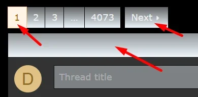

XF 2.2 How to edit "Page navigation"?
Dkf
Background gradient and other
Thank You

The inspection tool that most browsers come with does wonders.
To get you started just a few of the CSS properties for the pagenav selectors.
.pageNav-page.pageNav-page--current {
background:green;
color:red;
.pageNav-page
background:purple;
color:cyan;
.pageNav-jump:hover, .pageNav-jump:active {
background: #171717;
.pageNav-page:last-child {
background:blue;
color:white;
.pageNav-page:not(:first-child) {
background: cyan;
color:red;
As for gradient... they are done using the background designator and simply using standard CSS for defining gradients.
similar to background: linear-gradient(0deg, #1f1f1f, #252525);
But since you are using a custom style... some...

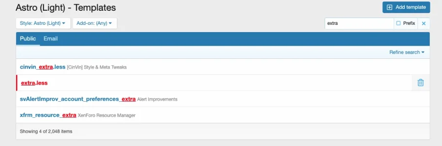

As @nicodak stated... those are CSS entries to place in your EXTRA.less that is specific to the style you are working on.
To get to it, you go into your ACP -> Appearance -> Templates, select the style you need to edit
and then in the filter box type in EXTRA and it will pull it up.
Then you can insert that code into there
