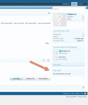

I'm trying to figure out where this template is so I can place some adsense code. It's the sidebar when inside a conversation:
Conversation Info
Conversation Participants
I'd like a banner under this. I tried editing the sidebar template without luck.
OK now I have access. Here is how you can do it in XF1.5:
Template: conversation_view
Last line is: </xen:sidebar>
Put your code above that line.
If you want to just put a banner, then use your HTML there (I recommend using Template Modification system instead of directly editing the template to avoid losing your customizations in future)
But if you want to add a content there that looks like those sidebar blocks, then use a block of code like this:
<div class="section">
        <div class="secondaryContent">
            <h3>the title</h3>
            <div id="anyID">
                any content that you want
            </div>
        </div>
    </div>
