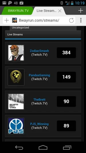

I know how responsive design works... this page works on responsive design:
http://8wayrun.com/streams/?view=detailed
When I view it on my cellphone, it looks as follows:
So I am making a new page at:
http://8wayrun.tv/
If you resize it in your browser, you will see that its responsive. But when I view it on my cellphone, it looks like this:
It appears that the browser is not dropping below a minimum width. How do I fix this?

Same thing happens in Chrome for Android.
How did you build the responsive design on that page? Are you attempting to do any user agent sniffing?
Emulating any mobile device in the Chrome dev tools breaks the page. It looks like it's not getting the viewport information from mobile devices.
EDIT: You're missing the viewport meta tag in your header:
<metaname="viewport"content="width=device-width, initial-scale=1.0">
Just press F12, click the drawer icon, then click the emulate tab. It has a list of devices with various screen sizes and DPIs.
