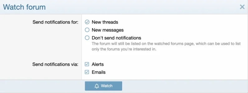

The user has confirmed they are watching the forum and the settings they are using are as follows:
