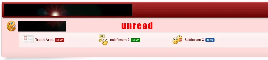

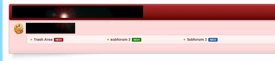

How did you get each sub-forum grid item to show its own icon?

I'm not proficient enough to know which templates to change and exactly what code to add. Any help appreciated!

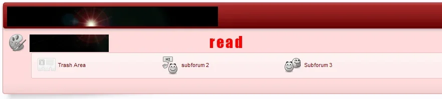

This I'm 99% sure can be done via css. I applied "new" indicators after the title that differ from one another so I assume node icons can differ also. I'm sure someone else will jump in with a solution before i do but to cut a long story short, extra css can be used here with the subforum ID used to display specific icons per sub forum. This is CyberAP's subforum add-on correct?
Basically, if you use a code inspector (firebug) or another apply your ID though if memory recalls you'll have to overide the background-color with a background (image)

edit: NM - I thought this was CyberAPs subforum manager and I almost have different icons on specific sub nodes displaying with css and extra.css but this is jaxels modification so any solution won't help here since I'm modifying cyberAps subforum code.
For those interested in doing the same using CyberAps subforum add-on via css.
The node IDs will most certainly differ as will the imagepaths to unread/read icons (you'll use your own custom imagery) and the width and height will almost certainly differ so it's basically adjust accordingly for your forum IDs/paths etc
All the code goes into EXTRA.CSS (bare in mind this is for CYBERAP's subforum add-on)
body .subForumsPopup .blockLinksList .node_32  .unread .nodeTitle a:before{
    background: url("@imagePath/xenforo/icons/node32-unread.png") no-repeat center transparent !important;
    height: 36px;
    width: 36px;}
body .subForumsPopup .blockLinksList .node_32 .nodeTitle a:before {
        background: url("@imagePath/xenforo/icons/node32-read.png") no-repeat center transparent;
        width: 36px;
        height: 36px;}
