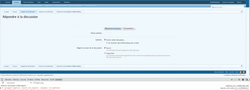

When I go back to my forums, basic users see no issue, but my moderators and I can't see the RTE. Quick edit does not show. "More options" leaves the RTE place blank (see screenshots below).

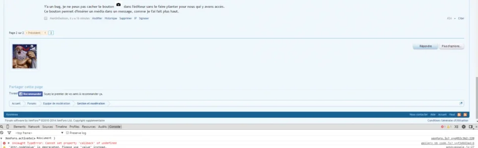

You can see below the empty space left by the RTE. There is a JS error in the console:
Same error on "More options" page, as explained before:

The error in firebug is :
Rich (BB code):
TypeError: c.config.buttonsCustom.custom_gallery is undefined
gallery...0e3f155 (ligne 6, col. 357)
