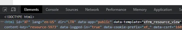

P Paul B XenForo moderator Staff member Jul 10, 2023 #5 Add any additional pages to the code like so: Less: [data-template = "xfrm_resource_view"], [data-template = "other_page"] { .p-title-pageAction { visibility: hidden; } } Use the browser inspector to check the template name of the page you want to affect. Upvote 0 Downvote
Sirmadsen Active member Jul 10, 2023 #6 Brogan said: Add any additional pages to the code like so: Less: [data-template = "xfrm_resource_view"], [data-template = "other_page"] { .p-title-pageAction { visibility: hidden; } } Use the browser inspector to check the template name of the page you want to affect. View attachment 288327 Click to expand... Hmm, adding any other page to that makes the button visible on all pages. I added Code: /** HIDE DOWNLOAD BUTTON **/ [data-template = "xfrm_resource_view"] [data-template = "xfrm_resource_history"] [data-template = "xfrm_thread_view_type_resource"] [data-template = "xfrm_resource_extra"] { .p-title-pageAction { visibility: hidden; } } Upvote 0 Downvote
P Paul B XenForo moderator Staff member Jul 10, 2023 #7 You missed the , after each template line to separate them. Only the last entry doesn't have a , . Upvote 1 Downvote
Sirmadsen Active member Jul 10, 2023 #8 Brogan said: You missed the , after each template line to separate them. Only the last entry doesn't have a , . Click to expand... Aah, thanks. That did it. Upvote 0 Downvote
