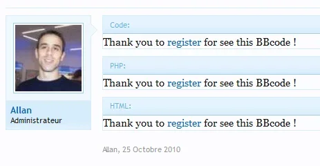

Before

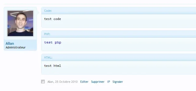

After
Thank you to register for see this BBcode?
Shouldn't it be "Sorry you need to register to see this."

Thanks. works fine.

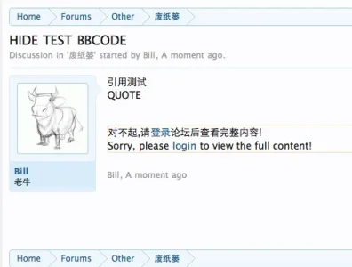

QUOTE:
bb_code_tag_quote
find 搜索
<blockquote>{xen:raw $content}</blockquote>
Replaced by
替换为
<xen:if is="!{$visitor.user_id}">
对不起,请<a href="{xen:link login}">登录</a>论坛后查看完整内容!<br>
Sorry, please <a href="{xen:link login}">login</a> to view the full content!
<xen:else />
</xen:if>
