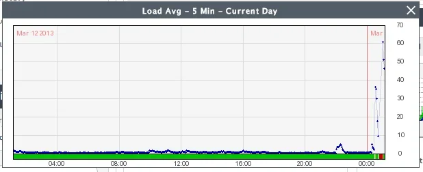

I recently added another forum to my VPS and traffic on both forums has been picking up. It's not uncommon to see 100+ users on at at time between the two sites. Things have been starting to slow down at times and I've had some database connection issues so I asked my host to look into it and they suggested the changes below.
I am totally clueless on how these changes can effect my XF installs so I'm hesitant to just tell them to go ahead with the changes. Any input would be much appreciated.
