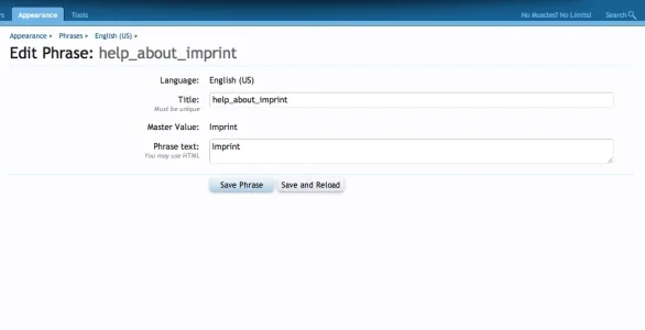

Screen Shot 2013-07-13 at 6.16.09 PM.webp Ok so like here... this style has this "Imprint" page, and its under the help menu... I want to change this... so do I change BOTH the titles there??I swear I thought I had already tried to do that on another page and it didn't work, although I am confused by now. LOL!
help_about_imprint isn't a default help page, so I'm not entirely sure if it works in both cases. My previous post (posted as you were) lists the phrases you need to change for the default pages.
You do not want to change Title, this is used to refer to the text. You want to change and modify Phrase text to change the value and what is displayed to the user.
