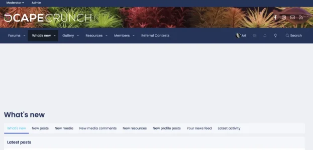

ArtG Well-known member Dec 13, 2022 #1 I have this annoying gap when I click on the What's New in my forum that I can't figure out where it's coming from. Anyone have any thoughts? Attachments Screenshot 2022-12-13 at 4.50.24 AM.webp 38.7 KB · Views: 2
D Deleted member 184953 Guest Dec 13, 2022 #2 There is an additional class margin-add added to p-body-inner in the template. Less: .margin-add { margin-top: 290px; } Upvote 0 Downvote
