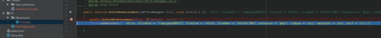

Debug screenshots:
Then after pressing f7 (Jump into) next line:
Exception: Call to undefined method XF\FileWrapper::addMetaData()
o_Oo_O
Strange right?

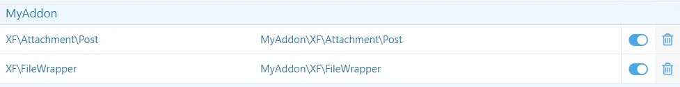

And class extensions in admincp:

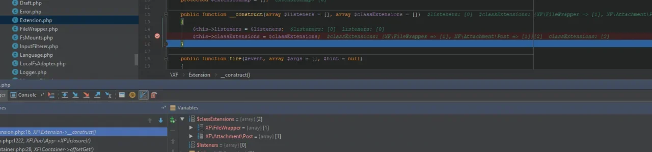

I tried adding breakpoints to extension.php too
As you can see, it loads both class extensions in __construct method of \XF\Extension class when I debug.
and It only loads the attachment handler class extension with the class proxy system, But not the FileWrapper extension when I running the debugger here:
