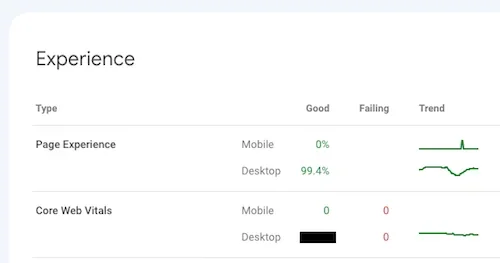

Checking Google Search Console...it says:
I'm running modern Xenforo forum software (version 2.2.5)...how the heck can this be possible (0% good URLs on mobile)?
If it's not Xenforo itself...what sort of setting/settings could there possibly be to cause this (and needs adjusting)?
Could REALLY use some help with this please.
Thanks
No it's not. I have 99,4 for mobile and 100 for desktop.
You probably have some large extra js/css (like google ads and custom skin).
If you give a url it will be easier to understand. You can send me by PM if you don't want to revile it by some reason.
Update for anyone following. Looks like page loading speed on Mobile seems to be the main issue. Desktop scores are great...but mobile not so good.:(

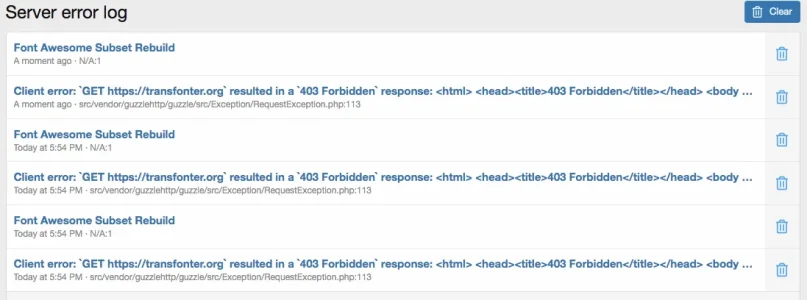

And I got these server errors:
Thanks for the help.:)

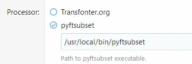

From the errors it looks like you're still trying to connect to Transfonter.org (which doesn't work anymore as per the most recent update) - you need to tick the pyftsubset add-on option and add the path on your server where you/your host has installed pyftsubset:
Thanks VBX...I think your 100% correct.
I'm currently trying to find out from the host company where they installed pyftsubset...so I can enter the path on the XF Admin area.
Thanks for verifying.:)
p.s. Update. Found out what the install path was & updated the settings. Everything (so far) looks good (as far as the FontAwesome Manager install)!:)
