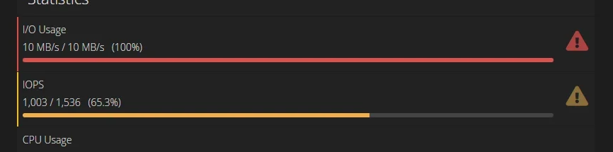

So I have a website during development, so it is barely used. (just some robots etc). Just be doing some work here and there alone.
Even so, I'm getting resource limited by my host due to job.php causing I/O limit to be reached..
Is this normal? (that high I/O usage on a barely used site).

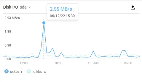

I looked at my busiest site and my disk IO is nowhere near the levels you're seeing:
... the peak IO level was during the database backup window. The rest of the day, IO was peaking at no more than 500KB/s.
I have a new host now, and even here it is reaching (sometimes) the new peak of 10 MB/s even when it's not happening much on the site... Just me clicking around a bit on the different tabs. So definitely something strange here..

Shared host.
No bots, doesn't show anything strange in the logs.
Yes the server has 4 GB of RAM, so more than most shared host plans I've seen (around 1-2 GB usually). RAM is never near the limit as reported by cpanel resource usage. When I look back at the last month, all resource usage is super low (as expected with a barely used site in testing), except the I/O usage.
