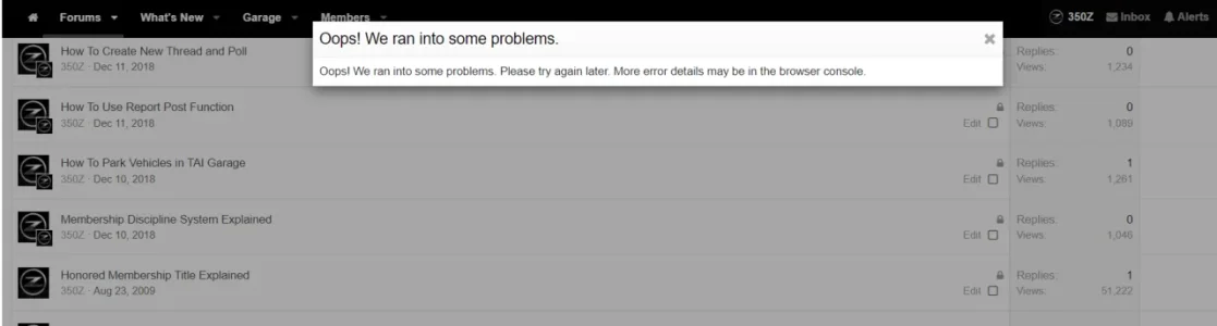

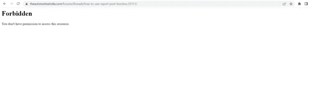

Hello,
We have a thread in one of the Forum Sections with the following link:
I renamed it sometime back from “How To Report Objectionable Content” To “How To Use Report Post Function”.
Name in the link naturally changed but software identifies threads with Thread ID which remains the same:
However, now both links are throwing 403 Forbidden Error. It has never happened with me in the past.
I'm even unable to rename the thread back to original as the software tells me it's unable to do so.
I contacted our server support but they say it's software-side issue. I'd appreciate if anyone can help resolve this issue.
PS: I don't know yet if this problem is limited to this particular thread or happening with any other thread as well.
Thanks

This is incorrect - a forbidden error is a webserver error, happening outside XF.
Hi @Brogan.
I shared this with server team and following is their response after investigation:
I found that the 403 error returned when visiting the URL does appear to be blocked due to either the web server or the application. I also found that a 403 error is returned by simply visiting /forums/threads/function./ , so that indicates the string "function." is being blocked for security reasons.
I checked the Apache error log for any ModSecurity violations, but none are occurring at that location. There are no log entries related to the URL in fact, so that does indicate the application may be returning the 403 response and Apache is simply sending it along. I found there is code in the Xenforo library directory related to 403 error responses, so it does appear the application is capable of sending the error.
If that is the case and you are not able to determine where in the application the 403 error is being triggered, we can most likely take a backup of the database and attempt to edit the post title manually. That is of course assuming the threads can be easily modified by hand. Let us know if you receive any more information from Xenforo or need any further assistance. Thank you.
Now, the problem is that whenever I try to edit title of that particular thread, XF throws an error (attached in the first post).
